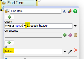

I want match itemtype == Talbe_getcolheader(), but it seems failed, how can I do it?

"token" is not defined in the query. You need to use the $-syntax to pass the token (or its label) as a parameter into the query.

Ok, thanks you!  I get it.
