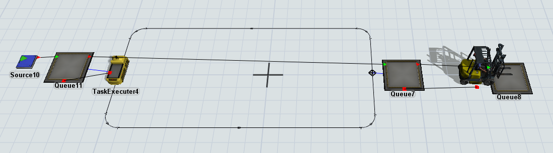

I am trying to load an agv/taskexecutor with four pallets (containers) and then unload them. I want to have them loaded and tugged to a location where they are then unloaded by a forklift and dropped close by. I am considerably new to flexsim, so the best way might be to show me a model of a similar process so that I can get a feel for what is really going on. There might even be an easier way, perhaps without an agv, etc. Any information will help. Thanks!
430 Views
adrian_haws
@Lincoln Sellers Here's one way you could do it (see attached model). As shown below, we connected a source to a queue, used a Center Port connection from the queue to the task executer, and regular connections from the queue to the control point on the AGV path, from the control point to the task executer, and from Queue11 to Queue7. A second control point is connected to Queue7, and a Center Port connection is connected to the transporter. On both Queue11 and Queue7 be sure to check the "Use Transport" box in the Properties->Flow tab. Also, in the source change the FlowItem Class from "box" to "pallet."

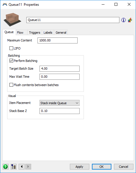

In the properties menu of Queue11 you can tell it to perform batching so that 4 pallets are loaded onto the task executer at a time.
The last step is just to change the task executer's capacity from 1 to 4.
