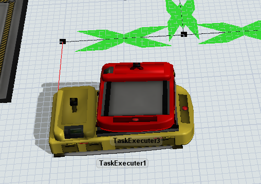

Hi.
I'm trying to group Task Executors, but I don't know how to do this.
I think its simple but I can't find where to do this.
multideepsample.fsm
Like this sample model,(Task Executor 1,3 are operating together) i want make group Task Executors.

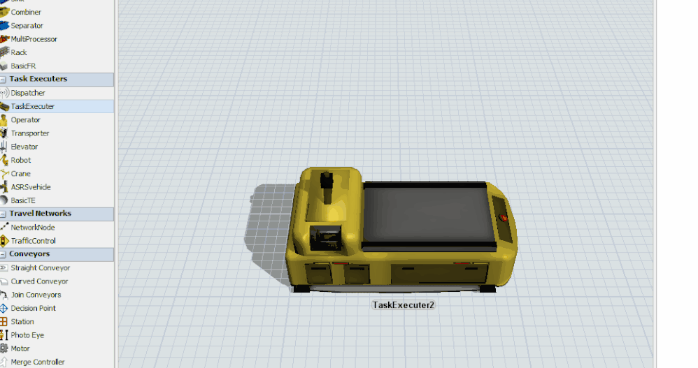

@jeoung_ho.d,
In the example model you posted, TaskExecuter3 is a subnode of TaskExecuter1. The easiest way to set that up is to drag a TaskExecuter from the library into another TaskExecuter already in the 3D model. This is shown in the gif below:
Note that you'll receive a warning message. You can test that one TE is inside the other by clicking and dragging it. The container TE will not move when you move the TE inside. But when you move the container TE, both objects move together.
