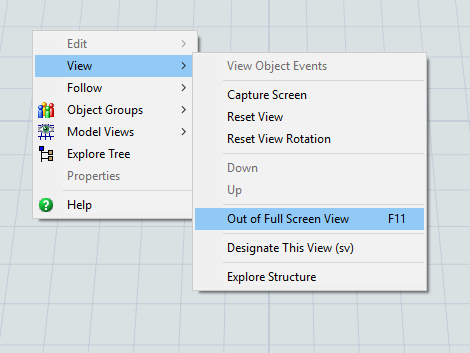

Matthew_Gillespie
Pushing F11 toggles full screen mode. The Esc key will exit full screen when in it.
You can also right click and find the option under View:
