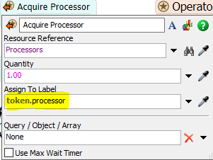

How will this work if your resources belong to a group ? I would like to refer to the resources acquired so operators can go to a corresponding queue where they have to unload. I do have 3 resources, operator (2), crane (1) and machine(2). Each machine has a corresponding queue where operator has to unload pallets according to what machine has being acquired. @Benjamin W2

moehlmann_fe
When acquiring a resource that reference a group, the acquired object will be assigned to the label you set in the "Assign to Label" field in the acquire activity.
From there you have multiple options to get a reference to the correct queue. The easiest two would probably to either have each processor have a label that points to the correct queue or use a- or s-connections. Both cases are demonstrated in the attached model.
PF_Referencing.fsm
You could also, similar to the original question, get the index of the processor in the group and then use that number in some way to find the correct queue.
Group("Processors").indexOf(token.processor)

@Felix Möhlmann Thank you! I knew I had to use a label on the processor but I did not know how to make the connection to the Q. The example is spot on!
