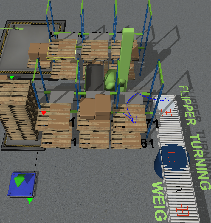

Dear @Felix Möhlmann I have last question about it, can you please give me advice. I have only 1 buffer and 1 output. My forklift is available only 5 min. every 30 minutes. So in time 4800 buffer gets block.
I need to optimize the machine and in this moment when it is blocked, ASRS must continue to do different job.
blocked-buffer.jpgBut how can I add in decision point if the Photo eye (buffer) is blocked, then continue to other work by priority and later when it is clear again, load the pallet and unload on buffer?
Thank you for advice, if you know.

The simplest approach might be to just wait for the first conveyor section to be empty every time.
feroll-no-position-defined-1011-161122-fm.fsm
The expression to read the photo eye state (or the state of other objects) would be the following:
Model.find("Buffer 1").as(Object).stats.state().value == STATE_BLOCKED
