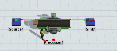

I have review a few answered questions as to how to have a operator wait till the processor finishes before continuing. But. If you track their state the time sitting while the processor works is called "idle" on the operator. In my case the operator is running the processor so the operator is "filling", not idle. I see the Task Executor Sequence. How can have the "Delay Time" field be "wait until the processor is finished"? That way I can assign a state of "filling" to the operator.

This can be solved if you set the processor to use the Operator in the 3D model. For example, take a look at this simple model.
Connect the operator using a center-port (S) connection. Double click the processor and check the box that says "Use Operator(s) for Process".
When the operator is working at the processor, his state will be "utilize".
If you want the state to read "Filling" on the state charts, simply open the chart properties, and change the Display Name next to utilize - 22 to "Filling".

I found the issue with the custom code change state. I happen to see another answer that stated you need to put a delay in front of the custom code with a small delay to allow the previous block to complete its state. I now, with the custom code, see the operator at the processor in a Utilized state.
