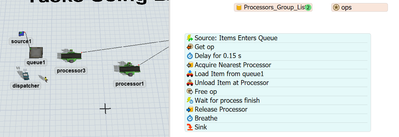

Thanks! I played around with the model, and-
The logic (see screenshot) is:
  • Source: Items Enters Queue
  • Get op
  • Delay for X seconds
  • Acquire Nearest Processor (resource group)
  • Load Item from queue1
  • Unload Item at Processor
  • Free op
  • Wait for process finish
  • Release Processor
  • Sink
What I’m seeing:
  • If the delay between Get op and Acquire Nearest Processor is 0.15 s, the operator always goes to the nearest available processor (as expected).
  • If I change that delay to 0.10 s (or remove it), the operator sometimes goes to a farther processor instead of the nearest one.
Why would changing this small delay affect which processor is selected as “nearest”?
Is this related to event ordering / when the distance is calculated, and is there a better way to guarantee the operator always chooses the nearest processor without using an arbitrary delay?
Thanks!
FelixMoehlmann
The process time of the processors is 0.1s. The operator is released after the item is unloaded, the processor is available again 0.1s later. If the delay is 0.1s or less, the processor has not been pushed back to the list yet, when the next token pulls one (when delay and process time are equal the timing depends on the order and amount of events, which in this case works out to the token pulling first before the release happens).
