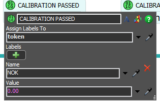

I have a batch of products packed on a pallet. I perform an operation on the entire batch and after this operation I have to separate some OK.product and NOK.product in the processflow "Calibration result". So the question is : How we can assign a label (OK or NOK) for each boxes in the process flow "Calibration result" ?

You can use an AssignLabels or CustomCode activity.
In the "AssignLabels" you just replace 'token' with a pointer to your box.
In your model it's less obvious what that should be since you're not creating/storing a pointer to boxes and are relying on finding the first object in a process at the time each activity is invokes - that's a design choice.
