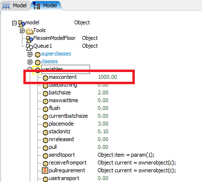

tanmay_varshney
[ FlexSim 19.0.2 ]
I want to access the data of node type through code, how can I access.
Node type is a subnode of conveyor, where "type" node represents which conveyor type it follows
Actually I need to access a conveyor type from a trigger when a part flows inside the conveyor,
kindly help

Hi @Trex,
Have you tried using the below function?
getvarnode(myObject, "node").value
For example, if I wanted the "maxcontent" value on a Queue like in the image below, I could use the following code.
getvarnode(Model.find("Queue1"), "maxcontent").value
This line of code in the example would return 1000.00.
You didn't upload a model, but I'm assuming that if you have things set up correctly, you can read the object's type in a similar fashion, but using a trigger on an entry transfer or photo eye or something. If you post an example, I'd be happy to show you what I'm thinking could work.
