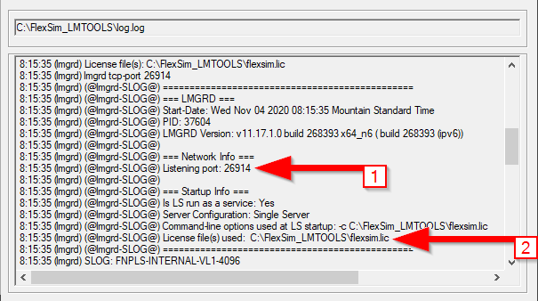

These screenshots are more illustrative of the view of the log file through lmtools:
  1. lmgrd.exe is listening on port 26914. This is the port the licensing service will use when listening for client PC communication.
  2. The bootstrap license file flexsim.lic was found and loaded. (This is not a license file specific to you and does not contain your license info. FlexSim licenses use Trusted Storage and licenses are activated to your license server using flexsimserveractutil.exe).1673709041097.png
  3. The flexsim.opt Options file was found and loaded.
  4. A list of product features activated in your server's Trusted Storage. Your feature set may differ somewhat from this example, depending on your license and product, but you should see several of the features above.
  5. 900 seconds is the minimum timeout allowed by FlexNet, and we configure our installation to use this minimum value using the options file.
  6. The flexsim.exe vendor daemon is using port 56914.
