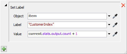

You can use the On Creation or On Exit trigger of the source to create a label when the people are created, based on the total output so far.
In these fields, item refers to the created or exiting flow item, and current refers to the source itself. I hope it's fairly obvious what current.stats.output.count then does, the only thing to keep in mind is that the flow item has not yet exited the source at the point the label is assigned, so for the first flow item the output count will still be 0 - hence the + 1.
