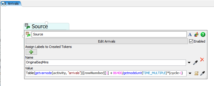

moehlmann_fe
As Jason said, it seems like you are using an "Assign Labels" activity. The rownumber and cycle values (and the correct 'varnode') are only available when the token is first created in the Date Time Source of the Arrivals flow. So you have to assign the label there. They are automatically copied to the patient that the token creates afterwards.
