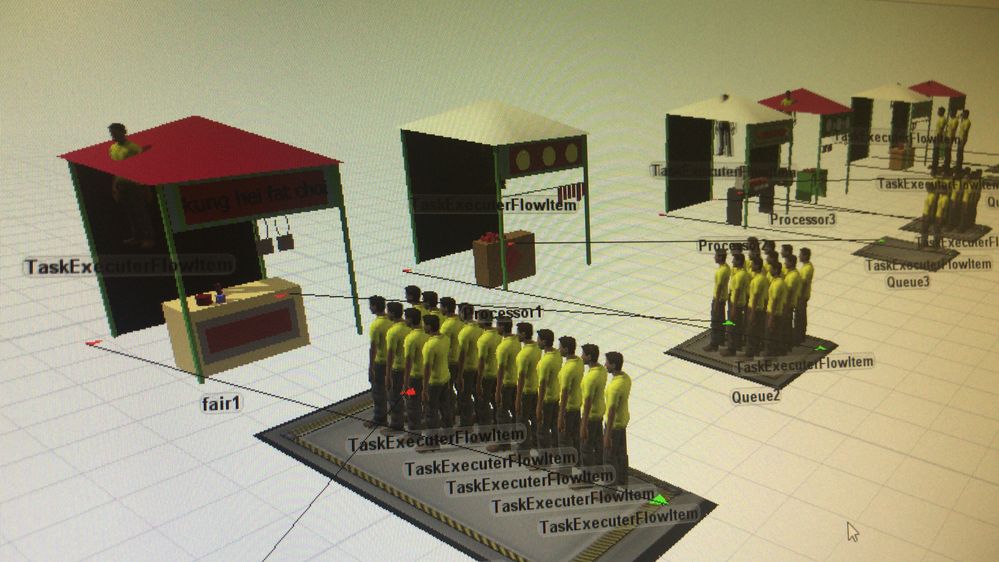

I am trying to simulate customers queuing in a fair, but why all customers, which is the "Task Executive Flowitems", coming from the Source, look exactly the same. (Like the photo attached below)
How do I change the colour of the people, Task Executive Flowitems, like the following photo? Thanks!!

In the Source's On Creation trigger you can use the Set Object Color pickoption to set the color of the person the source just created:
