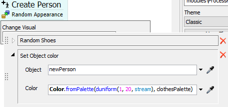

When you add a patient flow it adds a Random Appearance activity. This activity is a Change Visual activity and it randomly chooses different colors and clothes.
The code for determining the shirt color is in the Set Object color popup. All the person's shirts are set to use the object's color so you just need to set that. The initial line of code just chooses a random color from the 20 preset options in the clothesPalette color palette:
Color.fromPalette(duniform(1, 20, stream), clothesPalette)
