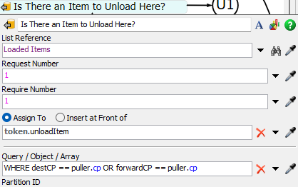

Furthermore I then noticed that there has to be a small change in the AGV Process Flow after all. If an AGV does not fully load at a PickUp point, it would continue on the NextWorkPoint loop and never reach unload the items, if the destination was not part of the work loop.
To fix this, I altered the "Loaded Items" list slightly by adding another field that contains the WorkForwarding point of the destination if there is one.
1673435399555.pngUsing this in the query then allows to start the unloading when the AGV arrives at either the destination point itself or the WorkForwarding point of the destination.
