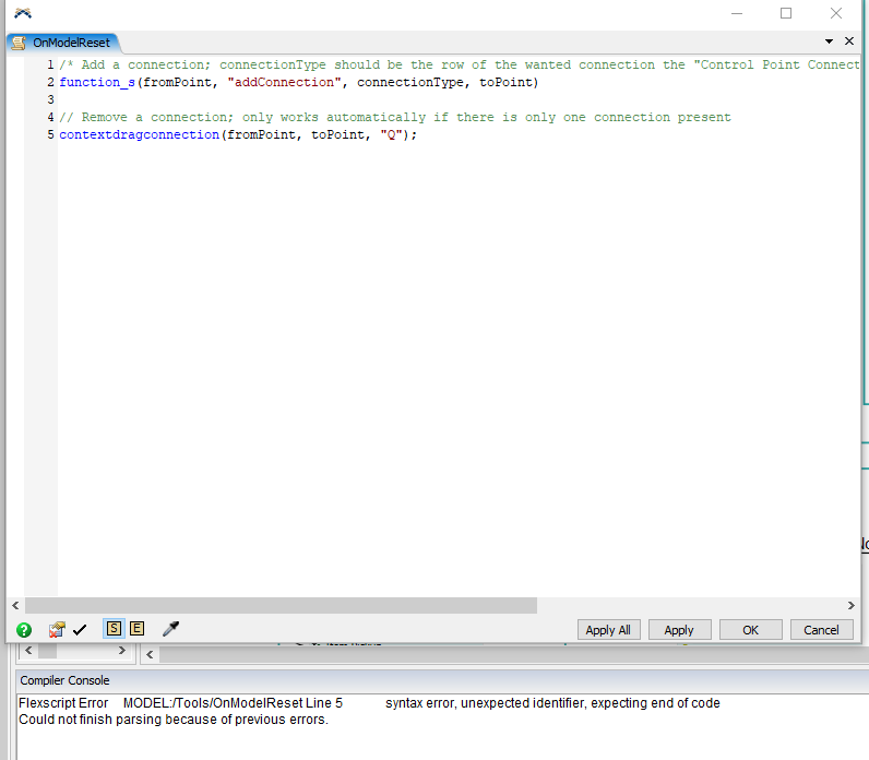

From reading @Felix Möhlmann answer, I believe he intended you to put the code in a model reset trigger.

Thankyou very much @Jeanette F for your reply. I added the above code into Model reset trigger but it was showing an error in the below pic. Could you please help me?
