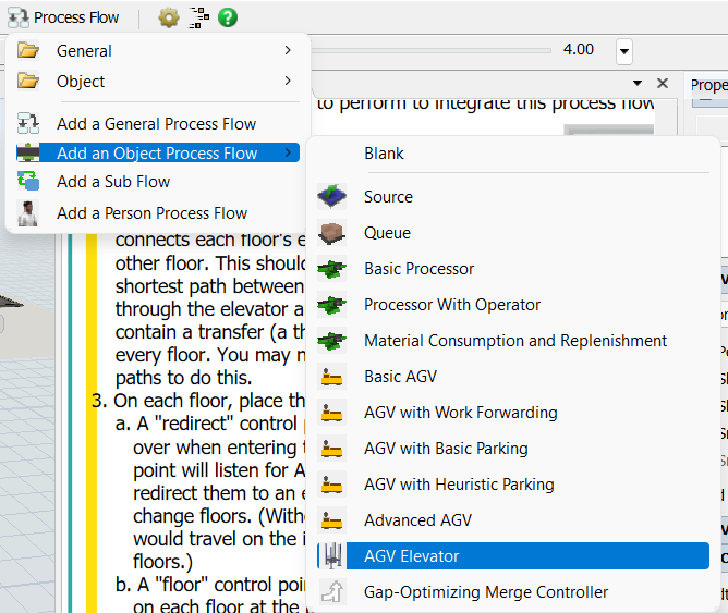

Hello @Jay K9,
If you add the AGV elevator process flow
and follow the instructions for integrating the elevator (These are in the elevator process flow)
Then the operator will be able to use the elevator to take flowitems from one floor to another.
Please, see my attached model for more details.
