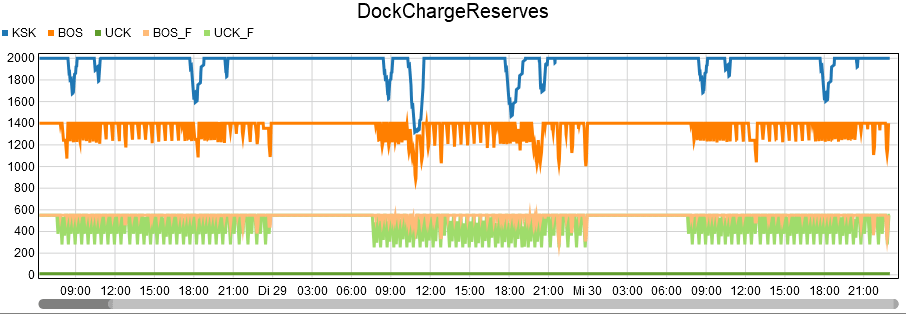

Hi again, @Felix Möhlmann. I hope your health is good and having a good day. Again, there is one last time I'm in need of your help and guidance. Dock batteries sometimes misbehave.
-They tend to overcharge:
-They tend to recharge when no ship is charging (e.g. at night):
v9_Final.fsm
Can you please help?
Message 19 of 23
moehlmann_fe
The smaller peaks you are seeing in the first screenshot are graphical artifacts that happen when there are points that form a triangle are very close together on the x-axis. The actul data point is at the cap but the line sort of 'overshoots' because the triangle that forms the peak ends in a very acute angle.
These peaks will appear/disappear when the interval that the graph displays changes. You can set the graph to use the 'time window' on the x-axis and play with the interval to see this effect.
The larger rise above the max capacity and the recharging at night were seemingly caused by a floating point error, where 'reserve < maxCapacity' is evaluated as true.
I changed those checks to 'reserve < maxCapacity - 0.001' to prevent this.
v9-final-fm.fsm
