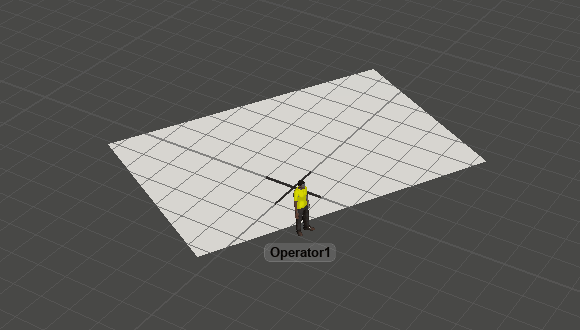

I was able to replicate all of the components you provided in my model, except for the "Operators Group." My operators are located in different areas of the floor plan and are grouped independently. When I attempted to create a group called "Operators" and set up a "NumOperators" parameter as you did, I saw an issue (I 'm just guessing this might be the cause of the issue). After I reset, all the operators from different groups moved to the same location as the first operator in the "Operators" group, and their appearance and names changed to match that first operator (as shown in the picture below). Also, the operators do not move when I run the model, and no data appeared on the Zone census chart.
Do you hink the Operators group is causing this issue?
How can I resolve this issue and make it work in my model?

I think we should create a new Question with the topic of Floor Zone Census for this. But why are you creating them from a parameter - that was just for my test model - doesn't your model already have operators defined? You just need a reference to all the operators in your model - I did it as a group and parameter as it's easy to set up. You should be able to do that too and select all the objects of class Operator. An operator can be in multiple groups so should not interfere with what you have already.

You should just be able to add a new group and select all the operators in your model.
