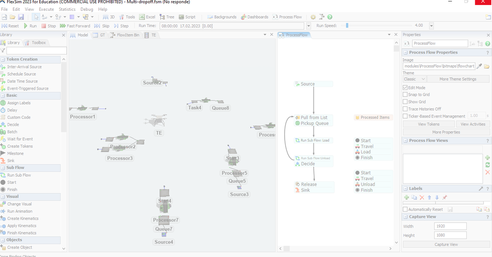

Hello everyone,
I'm reaching out because I'm experiencing some issues with FlexSim. I'm unable to open any version of FlexSim as the theme appears briefly and then closes automatically. I'm not sure what's causing this sudden problem.

Dear @Joerg Vogel and @Ben Wilson , I have tried some solutions to fix the issue, but unfortunately, the problem still persists. The model appears on the screen, but I am unable to perform any actions, and after a few minutes, it automatically closes. I am hesitant to reinstall the software because I am concerned that my license may not work.
So As a result, I am left with a stagnant screen for several minutes without any ability to make changes or progress. Ultimately, the application closes by itself.

@MPeyman Not being able to interact with a model right after opening suggests one of the following:
  1. an onModelOpen trigger that gets into an infinite loop
  2. an onDraw trigger that gets into an infinite loop
  3. a graphics issue (I think this one is less likely, but still possible).
To troubleshoot #1 or #2, can you attach your model?

Hi dear @Ben Wilson Here is my model:Multi-dropoff.fsm
I should mention that for any model and any version of FlexSim it happen.

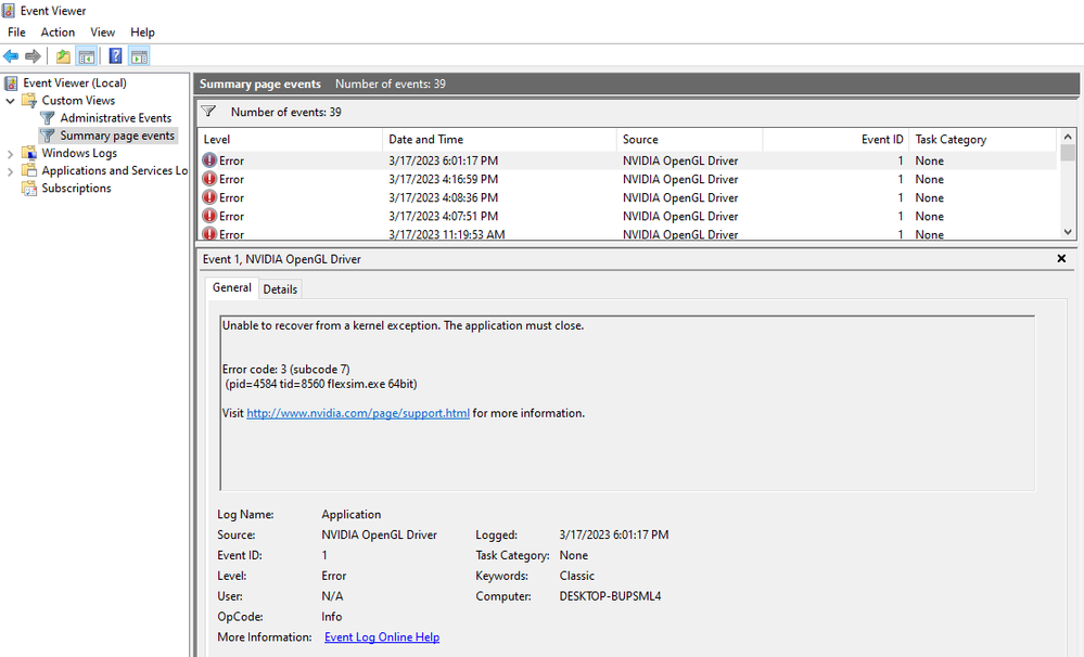

Dear @Jeanette F, Well, I contacted Marcello yesterday, I think it is the problem with OpenGL. I updated my NVIDIA and everything, and just now once FlexSim comes up when I want to open one of my models, it gets stuck again and comes out, then again it gets stuck on OpenGL and I can not open it.

Dear @Ben Wilson , The only things I can get from flexsim is this. after updated I got the first page of flexsim but then when I wanted open the model it came out and after that got stuck from the begining. I think there is some conflict between openGL and flexsim.

While your graphics card does support FlexSim's minimum requirement of support for OpenGL 3.1, due to the age of your GPU you don't technically meet the recommendation "To meet minimum requirements for performance, compatibility, and vendor support (such as driver updates) we recommend a GPU produced within the last 5 years".
You can see in your screenshot that your driver is from 2017. Nvidia does provide a newer driver for your 740M from 2019. It is probably worth giving it a try.
Please download the latest driver for your 740M graphics directly from Nvidia's drivers site. Enter your information to get a link to the best driver for your GPU:
Here is a direct link to the latest driver found after doing the search in the screenshot. I made some assumptions about your operating system, etc, so you may want to do your own search if the parameters in the screenshot are not accurate for your system.
Perhaps the newer driver will enable you to get past the Nvidia crash you're experiencing. After installing the latest driver and rebooting, you should see a newer driver version when you look at your GPU properties in Windows Device Manager.
Let us know your latest results after installing the latest driver.
Good luck!

dear @Ben Wilson , I followed your suggestion but the problem still exist.screen.png
