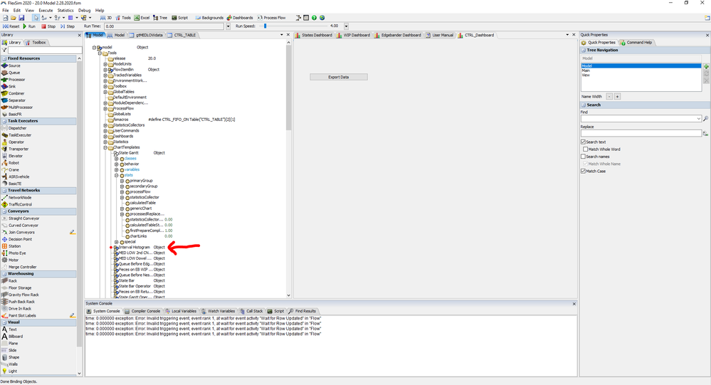

I am receiving an error message when I start my model for an activity that doesn't exist in my model.
When I search in the model tree for "Wait for Row Updated" nothing is found. I suspect this has to do with something in the background but I can't find it. It started after I deleted some milestones I had been experimenting with.
Can you tell me how to stop this error?

That sounds like it might be from a dashboard chart template. @jordan.johnson

I've gotten this from an empty (as in, not listening/attached to anything) Event-Triggered Source activity in Process Flow (see image). Do you have any Event-Triggered Sources or Wait for Event activities that aren't connected to anything in your PF? You might have to parse through the tree in case one is hidden somewhere in the PF.

I think it found it finally. I had deleted a milestone and deleted the chart I had created from the dashboard but it did not remove the chart in the tree. Once I found and deleted the chart from the tree I no longer get the error.
brittany_evansVMLMG
Charts do stay around in the tree even if you delete them from the Toolbox and the Dashboards because they could be used as Experiment Performance Measures. Therefore, if you are getting errors it is sometimes good to also delete them from the Tree as you found.
