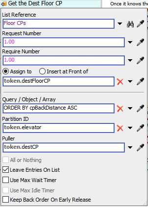

The distance that is used to choose the "destFloorCP" is the wrong. FlexSim seems to use the distance from the final destination CP to the floor CP, rather than the other way around. I think the assumption here was, that each floor would have it's own AVG loop so the direction the distance is measured in wouldn't matter. But because in your case the elevators are part of one big one way loop the wrong floor cp is chosen (starting from the destination the cp on the starting floor is closer).
Either switch around the "puller" and "value" in the cpDistance expression or use the "cpBackDistance" in the "Get Dest Floor CP" query (AVG Elevator Process Flow).

@Felix Möhlmann @Doris C Don't switch around the puller and value in the cpDistance expression. There are other activities (like Get the Current Floor CP) that use that expression and need it in the current order. Get Dest Floor CP needs to use cpBackDistance, but you'll have to add that as a new list expression field since it's not on the list in 19.0.
