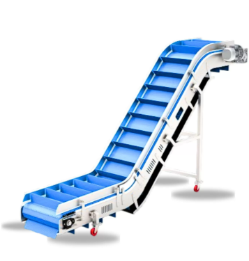

need to model a conveyor like this i need to change the orientation of my object

The best way to model a conveyor similar to what you shared would probably be to build multiple smaller conveyor sections at the angles required.

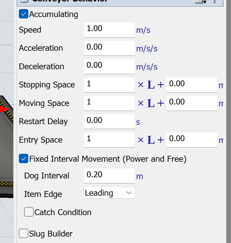

Jacob_White
Hi @Yogeshkumar_M
I am attaching a small model that demonstrates how to build a conveyor similar to what you described. It makes use of multiple conveyor pieces to achieve the desired shape. And it utilizes the power and free option (see attached image) that creates "cleats" on the conveyor to keep the spacing of conveyor objects consistent.
