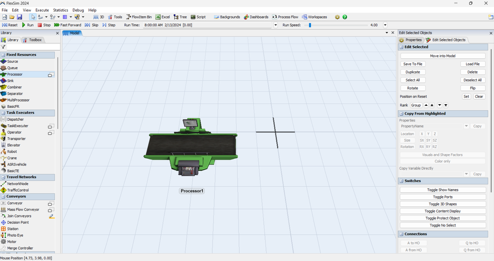

Hello Team,
I need assistance to resolve issue with *Edit Selected Objects". As you can see here in the screenshot, I believe I messed by the setting by selecting randomly. I am not able to select or delete the processor.

Try resetting the model and re-opening the default workspace.
hetkumar_patel
error.fsmThanks, Jason, for informing me.
I tried that. But nothing happens. I have attached the file as well.
Can you add new processor into the Model and select the all field from "switches" one by one? Suddenly, you will not be able to undo the changes.
jason_lightfoot_adsk
You've sent a model with a processor whose no_select switch is toggled on.
You can turn that off using:
Object processor=Model.find("Processor1");
switch_noselect(processor,0);
Is that the problem?
hetkumar_patel
You're the best. It works. I was able to remove that after applying script in console.
