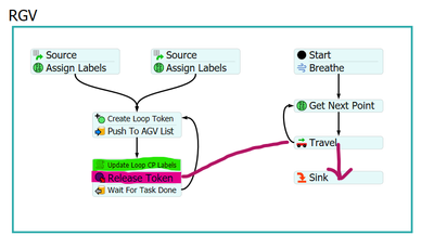

FelixMoehlmann
Here's something I came up with.
I added a new CP-connection called "NextLoopPoint". (I could have also used an existing connection type, but I don't want to interfere with those, in case you choose to use the AGV Process Flow template for something.) The connection is really just a convenient way to define a loop of destination CPs.
Each AGV-token is assigned a CP in one of the loops as their default destination. It then creates a child-token that is responsible for having the AGV drive around. This tokens checks if the CP the AGV is currently at has a "NextLoopPoint" connection. If so, the AGV is send to the next CP via that connection. If not, the AGV is send to the default destination.
Each loop is enclosed by a Control Area with a maximum allocation count of 4. One of the loop-CPs has two "NextLoopPoint" connections. If an AGV arrives there, a check is made if there is a pending request for the Control Area. If so, the AGV uses the second connections to determine the next CP to travel to, which sends it to the other loop, freeing up a space in its current loop in the process.
Pulling an AGV from the list is also different. The list is divided into partitions, depending on which loop the AGV is currently in ("10" or "20"). The 'main' AGV-Token actually waits in the Push To List activity until the AGV is pulled. When this happens, it releases its child token to a sink, stopping the loop logic. When the task is finished, the AGV is not directly pushed back to one of the "active" partitions, but instead is pushed to partitioned defined by the pulling token. This lets the AGV-token now that the task is completed. It then loops back up, creates a new Loop-Token and pushes the AGV back to either the "10" or "20" partition, depending on what the CP the AGV is currently at (the Loop-CPs all have labels that denote what partition they belong to).

The connection is really just a way to get a reference from one CP to another. Most of the CPs with a connection only have one and they form a loop. This allows the AGV to follow the loop defined the CP connections.
Some CPs (the ones in front of entry points to a smaller loop) have two such connections and two labels. If the "LoopCurrent" label value is smaller than the "LoopLimit" label, the second connection will be used to determine the next destination, so the that the AGV enters the small loop. Otherwise the first one and the AGV continues along the main loop.
The Process Flow works like this:
At the start of the model, a token is created for each AGV. These then create a sub-flow token that is responsible for having the AGV travel along the loop. Afterwards the AGV is pushed to a list (made available to be pulled for tasks).
The first thing the sub-flow token does is to search for the next "Loop-CP". If the CP the AGV is currently at ("AGV(token.OHT).recentCP") has at least one loop-connection, it can follow the connection (blue). If there are two connections, the aforementioned labels are checked. If the AGV is then diverted to the smaller loop, the "LoopCurrent" label on the CP is incremented and a reference to the CP is written to the label "CurrentLoopCP" on the AGV (green).
If the current CP does not have a loop-connection (either at the start of the model or after finishing a task) the code loops through all CPs belonging to the main loop. They are identified by being part of the "MainLoopCPs" group. It then chooses the one closest to the AGV as the next destination (pink).
This gets repeated after the AGV arrives at the next destination. The travel task uses the "TaskExecuter.MaxEndSpeed" expression for the end speed field. This means that the travel task will finish when the AGV would start to decelerate in order to come to a stop at the destination CP. If a new travel task is given to it immediately afterwards, they don't have to decelerate at all and keep travelling in the loop at full speed.
Now let's go back to the "main" token. When the AGV is pulled from the list, the token checks if the AGV has entered a small loop in the meantime, meaning the "CurrentLoopCP" label would be set. If that is the case, the label on that CP gets decremented again, since the AGV is now assigned to a task and as such does not count as "in the loop" anymore (at least that is what I assumed). It then releases the sub-flow token to a sink activity. Then it waits until the token that pulled the AGV is put onto a list to denote that the task is completed and the AGV should resume the idle travel.
So overall this logic assumes that there is one big main loop with smaller loops around it. To add more small loops, just draw the necessary connections and add the labels as shown in the first screenshot to the CP where an AGV would get diverted to the small loop.
