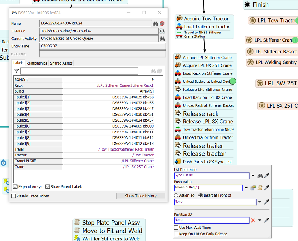

What is the correct dot syntax in push to list to push an array back to a list? I pulled 9 parts, did some processing on them and want to push them back to the list to get pulled by another token. Dot syntax is not my strong point.

If you just want to push all 9 items on the pulled label then you should set the Push Value to
token.pulled
This will individually push all the items in the array on the pulled label onto the list.
