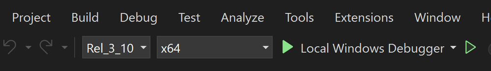

3) Open the FlexSimPy.sln solution in visual studio.
When trying to open the FlexSimPy.sln file in MS Visual Studio and trying to run it, I have several failures related to the debugger. How exactly should this be done?

3) You shouldn't need to "run" the .sln - you simply want to build it using the build menu. Ensure that you have the solution that you want:
Then in the build menu, select "Build Solution".
This will output the libraries and files you need to either make your own customized FlexSimPy module or to make a customized PythonConnector.
