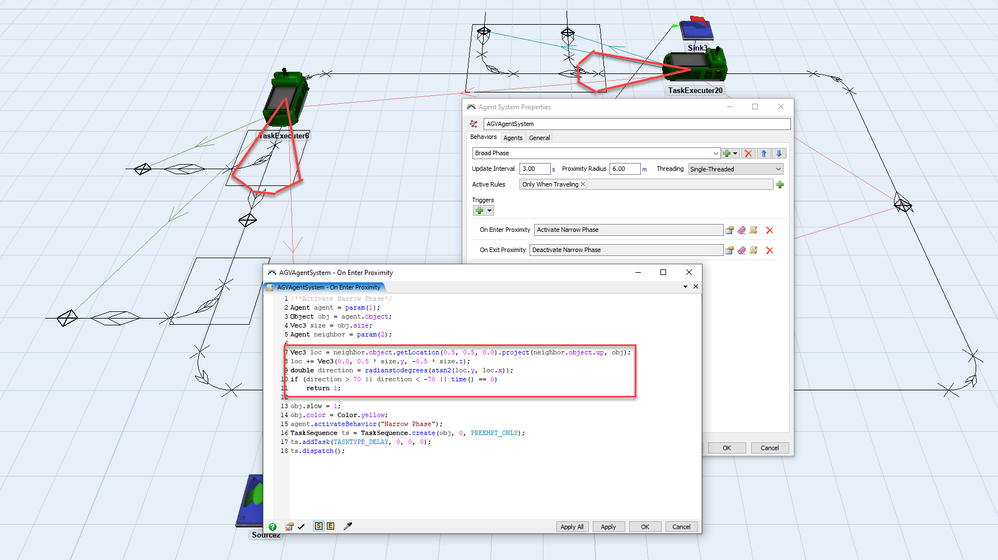

The agent system detects with a circular radius. I want to detect only in a limited range.
Here's information about @Phil BoBo's ideas, but I don't know how to implement it.
Do you have any good advice?

See the AGV models in the Agent Module Example Models - FlexSim Community
It gets the intersecting neighbor's location, projects it onto the agent object's coordinate space, uses atan2() to determine the direction that the neighbor is relative to the agent, and then uses an if() statement to ignore collisions that are outside a particular window of direction. (-70 to 70 degrees in the image above for example.)
In those example models, they use that code to avoid triggering proximity with AGVs that are pulled off the main loop onto the spurs.

I tried to fix it using the link model.
I want to shut down the agent system when the specified proximity range is exceeded, so I set the collision detection logic in OnInProximity.
However, it does not end even if it exceeds the expected range as shown in the figure below.
(It will end earlier than usual)
Is there a problem with the settings?

tsuji_ryusuke
I'm sorry I couldn't convey the information correctly.
In the original model, once it enter the proximity agent, it will not end unless it deviates from the proximity radius.
I wanted to terminate the proximity agent when it was out of a certain range. That's why I set On In Proximity.
I want to judge whether it is within a specific range for each update interval, and if it deviates from the judgment, I want to terminate the proximity agent.
Can this explanation convey it?

jason_lightfoot_adsk
It looks to me that you successfully deactivate the narrow phase when it falls outside of the +-70 degree beam. Is that not what you wanted?

Please check the attached image.
The yellow color of the AGV means that it is within the ± 70 degree beam. I look like I'm out of ± 70 degrees in this image.
Is my understanding wrong?

I think you may have had the relative position slightly wrong and certainly it did not account for rotations.
In the attached model I've added the drawing of the item location and made it relative to the front of the AGV. You can change the sensor position and check the effect.
twophaseagvsystem-gt_j2.fsm
I'm drawing a dot to check the position as the AGV sees it so you can check when it should be out of range:

Thank you for your reply.
This is exactly what I was looking for.
