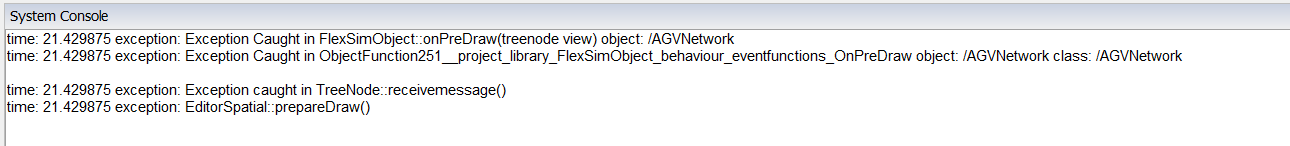

When using AGV to simulate trucks, after unload cargo task done, truck will travel to a control point that leave warehouse.I want the truck will be destroy and relaese the leaving control point.
When using destroyobject to delect AGV, output console will continue throwing error message.How to delect AGV correctly

Before you using destroyobject to delect AGV, please ensure there is no task in the AGV. The attachment is a demo for your reference.detroy-agv-in-agv-mode-v20182en.fsm

Thanks for your reply,but my case is a bit different from yours.
I need to add AGV and delete AGV dynamically.
After destroy AGV, the error message show like this:

The attachment is a demo for your question. 19793-destroyagv.fsm

Instead of redirect the truck via custom code. Use Travel activity in process flow to move the truck to the leaveCP location.
agv-truck-support.fsm

Thanks a lot. I got it.
