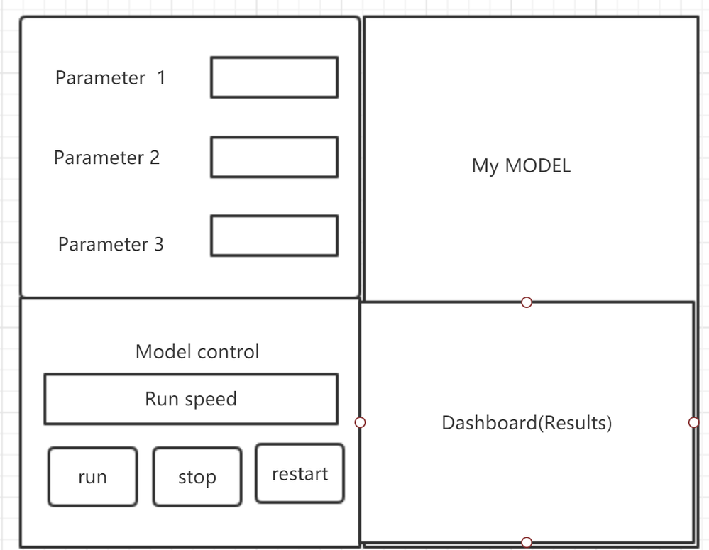

I already set up the web server correctly, and I want to create a custom page instead using the default page .

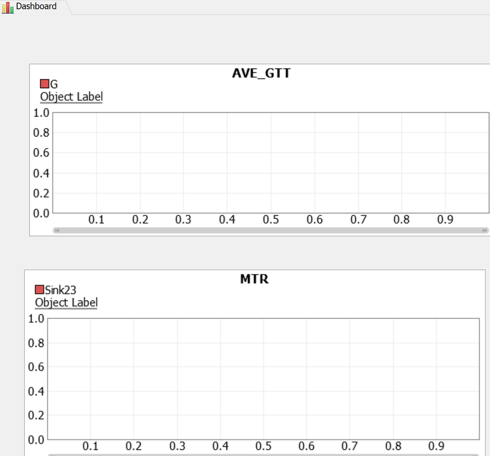

In my model ,I determine the parameters by reading specific rows and columns in the global table, and my results are shown in Dashboard .
I want my final page look like these
I would like to ask about the main points of the implementation process
Thanks.

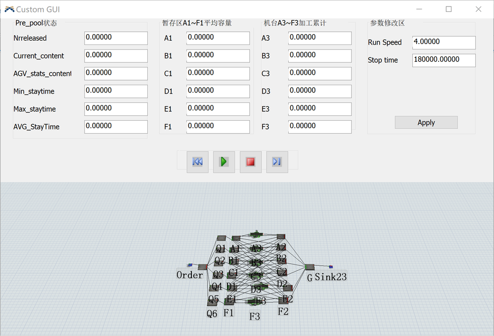

@tanner.p Thanks for your answer.My original intention was for customers who were not familiar with FlexSim software to be able to operate on established models without installing FlexSim software. When using web Server, use a custom web page instead of the default page.
And after logging in,the browser will open a page look like this :
31386-1595896615719.png These parameters are important during my simulation, and I set them in my custom code.

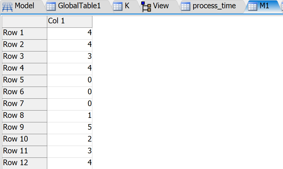

I use this code to set rules for Pre pool ,and I put K1 in a Global table.
I want to know if I can change the value of K1 in my code (or be able to read different rows and columns from global table )in a custom web page.
Now I am reading @phil.bobo 's FlexSim Webserver Example (https://archive.flexsim.com/threads/thread2916.html ) Trying to figure out how to develop my own page.
Message 4 of 11
iamfph
I've tried building custom GUIs, and my boss says this is not what he wants, he wants an interface independent of FlexSim where the customer can remotely control the model and see the results by adjusting the parameters. So GUI Building and Dashboard Widget sections in the User Manual is not a solution.

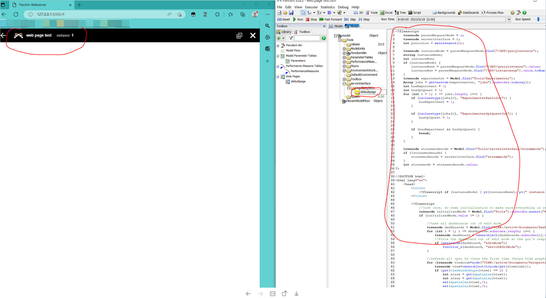

Crzdada
I created a custom page and named "defaultpage",then copy the code of node from MAIN:/project/exec/globals/serverinterface/pagetemplates/default and pasted to this page, at the end ,i tried to connect webserver and the page seem to have not any content, did I miss anything?
