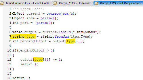

FelixMoehlmann
Updating the quantity should happen in the Pull Requirement code before returning the 1. That way it also works if the items don't move to the sink instantly but are transported there in some way.
You could simplify the check slightly by writing the hourly demand to the sink table at the start of an hour. Then you decrement the value by 1 and check if it reached 0. This also has the added benefit that you can keep leftover demand active when a new hour starts.

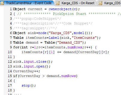

FelixMoehlmann
- The table name in the Reset trigger of the sink needs to be updated. The row headers of the itemCount label table should also be set to the column headers of the demand table here. We will see why later.
- The user event in your model now only happens once per day. The check that resets the global variable to 1 when it reaches 24 should thus either be changed to change it back once the day gets larger than the number of rows in the demand table or it should stop the model at that point.
- The type values in my example are numbers from 1 to 4. They can thus be matched with the columns from 1 to 4. Your type numbers are 'arbitrary' numbers. Using the type to read from the correct column can thus only work if the type is treated as a string (so it can be equal to the column name).
With these changes you now only need to make sure that the values that get assigned to the items as type are all present in the demand table (which they currently aren't).

FelixMoehlmann
- As I said, instead of stopping the model you could reset the "CurrentDay" variable back to 1 if it becomes larger than the number of rows in the demand table.
