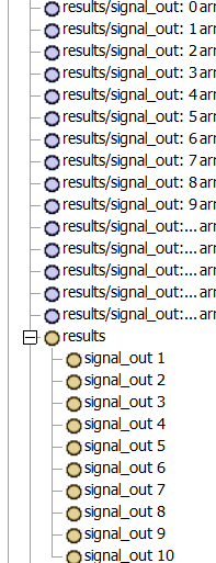

I'm currently creating a model in which I want to record some simulation results as label data. However, to distinguish between model setup labels and results data labels I wanted to create a label called "results" and then assign nodes within "results" to the different values.
Is there some way to do this, preferably via coding (Flexscript or C++)?

I managed to figure out this issue on my own.
If anyone has this same issue the following is the code I used.
Model.find("TaskExecuter").labels.assert("results");
Model.find("TaskExecuter").labels["results"].subnodes.assert(sig_out_channel);
Model.find("TaskExecuter").labels["results"].subnodes[sig_out_channel].value = Result_Data;
The trick was having to have subnodes predefined as nodes with subnodes cannot be dynamically created and allocated as normal nodes can.

I tried a few different things some of which I thought should work and some hail mary's that didn't really have a leg to stand on but my work based off syntax of other things.
The big one I was surprised about was...
Model.find("TaskExecuter").labels["results"].value = Result_Data;<---- this works
Model.find("TaskExecuter").labels["results"].subnodes[sig_out_channel].value = Result_Data; <--But this doesn't (sig_out_channel is a string type variable that is defined elsewhere so quotes are not the issue)
FlexSim seems to create label nodes on the fly if a value is assigned to a new variable. subnodes on label nodes are not created on the fly when data is assigned.
