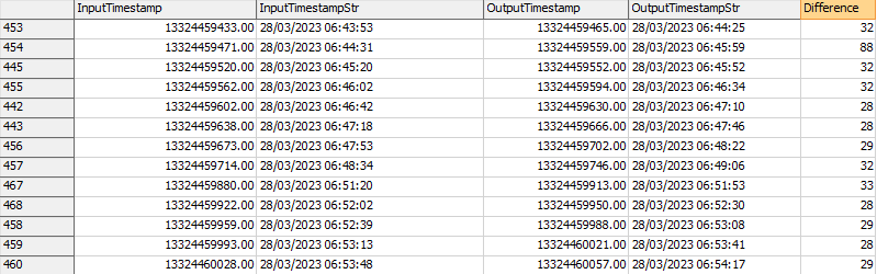

Hello !
I would like to take the time from my column called difference and transform my operating time of my robot. It is possible ? and yes, how to continue a line flow?

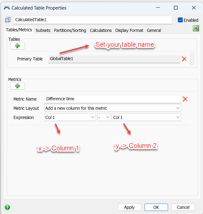

yumi_n2
Hi kauan, i think you can use the calculated table to put the difference time of your columns.
Probably you can use subset or partitions to filter by day and time.
The Calculated Table (flexsim.com)

Kauan
Hello @Yumi Nishijima
So I already have the difference value in my table but I was wondering how can I use the difference column values for my robot and the other would be how to filter my InputTimestamp by seconds or date. I saw that you put the Calculated Table option, how can I consume this calculated table and how to filter the seconds or date I want.
