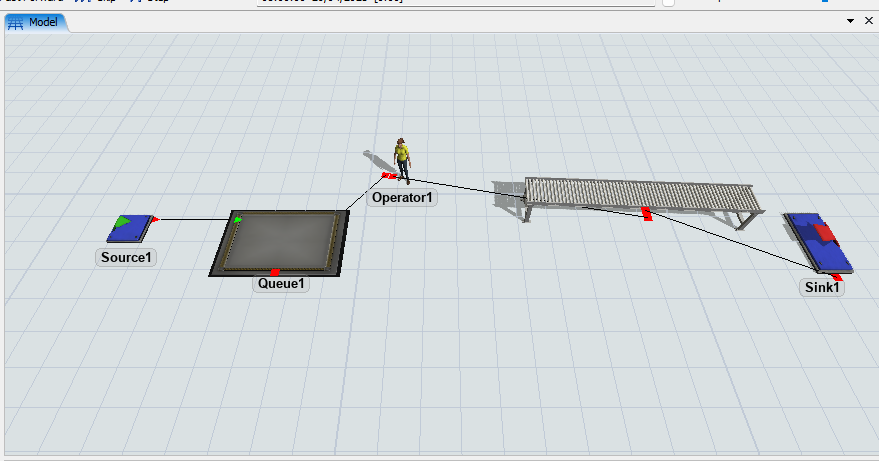

good morning everyone i'm having problem connection nodered to flexsim can anyone help me with the setting configuration please

You could use HTTP queries to communicate between a Node-RED server and FlexSim.
To call a Node-RED server from FlexSim, use an HTTP In node (cookbook.nodered.org) and call it via the Http FlexScript API (docs.flexsim.com).
To call FlexSim from a Node-RED server, use the FlexSim Webserver (docs.flexsim.com) to listen for instance queries and an http request node (cookbook.nodered.org) to send them.

kavika_faleumu
Hey @nada, have you tried using Emulation to make a Modbus or OPC UA connection with your Red-Node client? I noticed in this post that they had successfully made a connection using Modbus.

nada
acutally its my first time using both flexsim and node red i want to reed speed of conveyer this what i did but i dont know if the connection is right and even the flow .

kavika_faleumu
Hey @nada, you can read the speed of a conveyor using the "currentSpeed" property on a conveyor. If you have a reference to a conveyor, you can call it's properties to get and set properties on it.

nada
actuaaly i don't know what to put in variables configuration(initial value /register ...) and the actions are they correct or no
Message 7 of 11
kavika_faleumu
Have you taken a look at the emulation documentation to see what the different sections of the tab do? Or have you looked at the Emulation Tutorial which teaches you how to make an OPC DA connection along with how to tweak the settings?

nada
actually i did this example with modbus simulator and it works very well
i did also connect the modbus simulator with node-red it works also
but when i try to connect flexsim to node-red nothing happen
