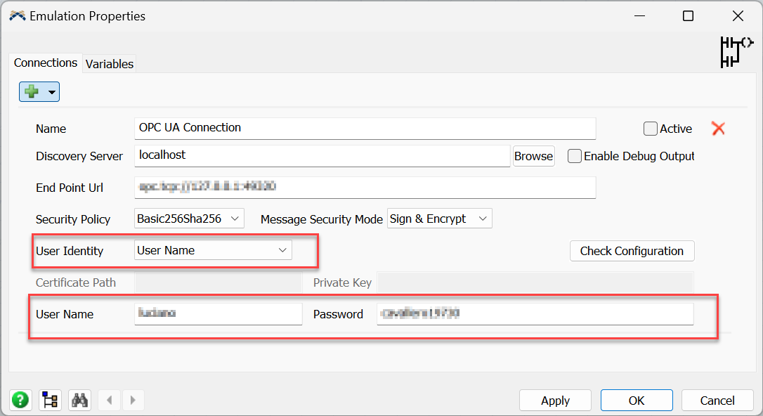

I am trying to connect my Simulation Model to PLC using OPC UA, it shows that model has successful configuration but its popping up with the following error while i am trying to browse the Node ID under variable section:
exception: Failed to connect the session: BadIdentityTokenInvalid on MyPLC. Error code 0x80200000 BadIdentityTokenInvalid
exception: Could not open OPC UA client connection on MyPLC. Error code 0x80200000 BadIdentityTokenInvalid

There is no process flow in the model as of now. i am just trying to connect the MODEL to PLC using OPC UA credentials given to me. the configuration seems to be successful but while browsing to Node ID variables section it shows "Server Browse Error" and pops with above exception error1674469970015.png

The message "BadIdentityTokenInvalid " refer to a invalid username or password you provided in the connection configuration when using "User Identify" set to "User Name"
The "Check configuration" button verify that the provided configuration is supported by the OPC UA server, but doesn't check username/password validity.
Username/password are sent to the OPC UA server when FlexSim establish a new connection like when you run a simulation, or, as you experimented, browse the servers.
Let me know if this solve your problem.

We tried the same user name and password while connecting to the PLC via UA Expert.
We were able to make successful connection with the same credentials. I don't know why we are not able to do the same with Flexsim. The credentials have been double checked.
Are we missing something here?
