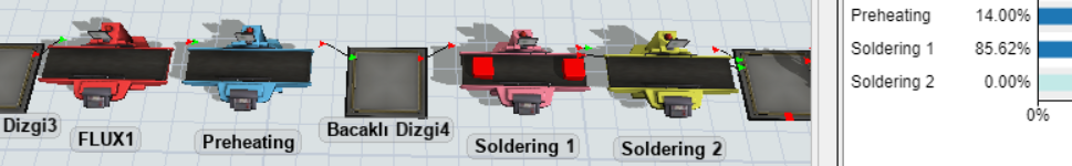

I think I ran your code properly this time. But I regret to inform you that this is not what the company wants. Soldering2 should work as a machine depending on the condition, not as a symbolic machine. If the total soldering time is 520, and the card remains in Soldering1 for 500 seconds, Soldering2 should remain for 20 seconds. (I don't know the times because they change). We managed to get the product directly to Soldering1 without waiting for any product in the Bacaklı Dizgi4. What I want now is to reduce the max content in Soldering1 to 1 and activate Soldering2.

I just realized I didn't add the triggers. After adding them, I got these two situations. They happen sequentially. In the first case, the product is still waiting in Bacaklı Dizgi4, which is not what we want. In the second case, as soon as the product arrives in Bacaklı Dizgi4, the product in solder1 goes to Bacaklı Dizgi. Which is not what we want, because it should go to solder2 and continue processing there. @Felix Möhlmann

The port connections order is still wrong. The first connections needs to go to the queue and the second to the second processor (or you swap the return values in the Send to Port code of Soldering 1)

Swap the order of the output connections of soldering1

Çok teşekkür ederim, tam istediğim şeydi!!!
