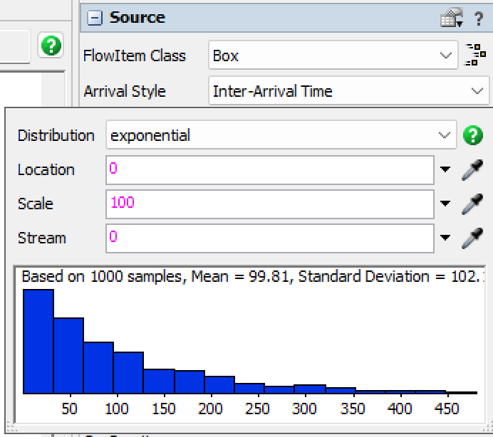

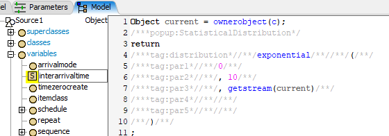

I have some questions about flexscript coding, how can I execute these steps using flexscript?
1. Modify the parameters of exponential distribution in the source property.截圖-2024-06-13-下午25557.png

1) Either set the source to use parameters instead of fixed values and then change those parameters. Or edit the text of the code node ("macth" and "replace" methods of the string class).
