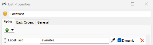

Would it work to use a time table to add or remove members?
I added the sublocations (individual chairs) of the multilocation chairs 1 to the time table. This can be done when you select the multilocation and in the properties panel under the Multilocation tab select the Edit Mode. This will allow you to select the individual members of the group.
I then set a label on each chair called available and set it to 1. This label will be used in the location list to decide if a patient can pull it or not, so it needs to be added to the list and resource filter.
