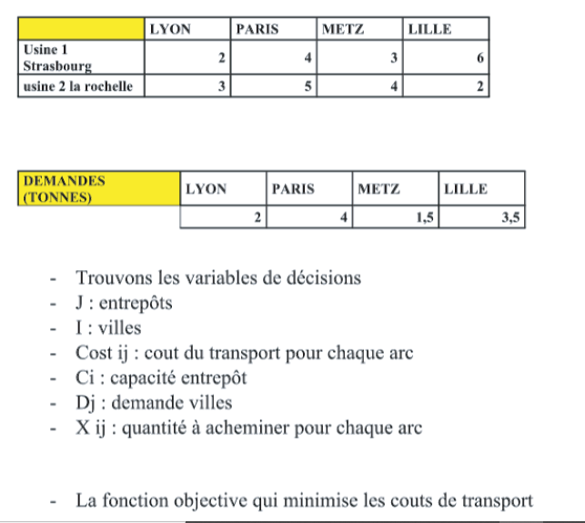

I'm having trouble moving forward on a project that I want to simulate on flexim. (I have 5 cities and a warehouse and two 10-ton trucks. Each of the cities has different demands. I would like to simulate this vehicle routing problem in order to optimize transport time and costs). Could you please help me.capture-decran-2022-03-26-133850.png

Hi @Melissa F2 ,
This sounds like a good question. However, it is currently posted as an answer to a previous question. I am working on the answer to your question. However, it would be helpful if you could post this as a new Question. That will make it easier for other people to find the question, as well as the answer.
