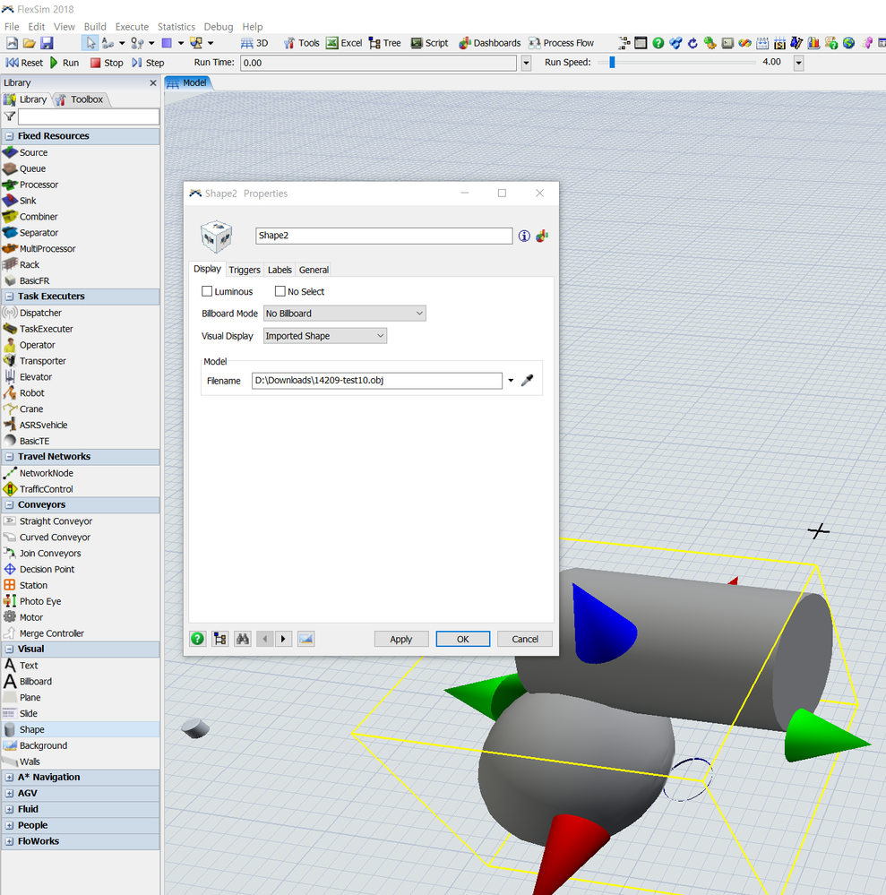

FlexSim can read obj format file like captured.
I attached the file.
Drag and drop Shape object from Visual group in the library and set the obj file in the filename like above captured.

The reason to show only yellow box in your model is FlexSim can't search the obj file in your model folder. If you set the obj file with the folder name like 'D:\working\14209-test10.obj', FlexSim display the shape of obj file not showing only yellow box.
