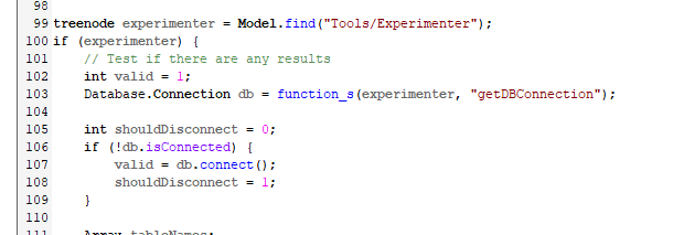

When you make a model, add the experimenter, but don't run it (Or rename your model such that the database is invalid) and then try to add a table to a calculated table you get an exception.
So I press on this button in the calculated table:
This leads to the following exception:
exception: FlexScript exception: VIEW:/active/QueryBuilderProperties1803507080/tabcontrol/TablesMetrics/TableMetricSplitter/TablesPanel/TablesGroupBox/TableList/Add>eventfunctions/OnPress c: VIEW:/active/QueryBuilderProperties1803507080/tabcontrol/TablesMetrics/TableMetricSplitter/TablesPanel/TablesGroupBox/TableList/Add
Where it seems to go wrong on line 106 in the code of the OnPress:
Below is the sample model I used.
ExpModel.fsm

Hello @Patrick Zweekhorst,
I will email this into the development team

@Jeanette F Was this ever resolved? Because I am facing the same issue where I am not able to add a stats collector table from the "Tables" add option.
JordanLJohnson
This appears to be resolved in versions 24.1 and 24.2. However, it doesn't seem to be resolved on version 24.0. I'll add the earlier version to the dev list.

alexander_s7
I had the same issue with 24.0.x and I could resolve it by running a short experiment in the experimenter and, thus, creating a sqlite file. After having done that, I was able to create calc tables without any errors.
