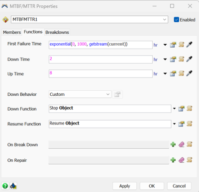

I have 6 different processors (named Chamber), I set MTBF/MTTR for these chambers but the problem is they wre still processing while on breakdown. what might be the problem?

First failure time is really long in the future of model run time. You have to find a suitable value for you, too. Otherwise you have to wait very long until you see a really fast alternating sequence of idle, processing and breakdown.
Edit: if this answer doesn’t solve your problem, it can be related to my bug report about a faulty state report, while a processor is stopped but statically the states aren’t processed correctly.
