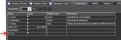

Hi everyone,
Following the advice from my previous post Controlling Item Release Between a Decision Point and Two Conveyor Stations , I managed to correctly control the routing and reservation of items between a Decision Point and two downstream stations.
Now I would like to ask about the best way to dynamically switch between:
  • using only 1 station,
  • or using both stations.
To do this, I added a model parameter (`num_ST`) with possible values `1` or `2`.
I modified the `On Arrival` logic of the upstream Decision Point so that:
  • when the parameter is `1`, only Station1 is considered,
  • when the parameter is `2`, both stations are evaluated.
The logic works correctly, but I would like to know whether this approach is considered appropriate or efficient within FlexSim conveyor logic, or if there is a cleaner or more standard way to handle this type of dynamic configuration.
I attached a model with my current proposal.
Any feedback or best practices would be greatly appreciated.

That's a good solution. You can clean up the code a bit by using "Model.parameters.ParamName" to get the parameter value. And you can also use the value as the starting value of the counter in the for-loop, making it so you don't need the if-else-condition.

Oh... brilliant.
I honestly do not know how I did not realize that myself. 😞
That simplifies the logic a lot and makes the code much cleaner.
Thank you very much again!
