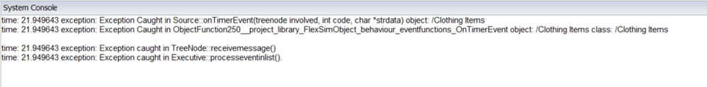

So my model runs fine, however, I wanted to also see if I can batch 10 items in the dynamic buffer and when it is released then the items can follow the process flow and go to wherever. For example, if 10 items are reached, 3 of them can go to the Autobagging station, 1 of them to Pack Station A, 1 to Pack Station B, 2 to Pack station A2, etc. However, when I run the process flow with this new batch it keeps sending all 10 items into one place and eventually gives me an error.

Your model is throwing errors right away, at 21 seconds. I don't know all the changes you made to your model since your last draft, so if you can debug these errors, it will be much easier to help you.

Those errors only happened when I swapped batch from the last draft to this new one. To answer the second question, I want to send items to different conveyor systems and different stations based on the percentages I already have within the model.

Hey @Aaupadhye! You were getting a few errors due to not having breathe delays and also pushing things to a list while also creating tokens for each item (essentially you were creating tons of tokens but pulling not enough). You can implement it without a list at all for what you're trying to do. I added that batching activity and fixed the routing! Here is the model:
