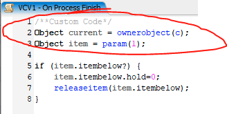

JakeT
Thanks for the comment Felix.
I have added your suggestions into the programme but the simulation is still not running properly. The main issues are:
1. VCV 3 is no longer being engaged at all
2. The 700T queues are not accepting more than 1 item causing the source to become blocked.
3. The 700T queues also enter a state of what appears to be constant releasing - which is causing the source to become blocked.
The aim is for the 700T queue to build up batches of 2 items, and then LIFO each item should supply the VCV (processor). the bottom item should not exit the queue until the top item has finished the VCV processor.
If anyone has any suggestion I would be extremely grateful.
I've made sure that all labels are worded the same. I'm getting these comments from the system console but unsure how to analyse and debug them.
Label property Type retrieved on /Queue1/Woman. Label does not exist. at MODEL:/Queue1>variables/sendtoport
Property itemBelow not available for Variant with value NULL. Must by a treenode type Variant. at MODEL:/VCV1>variables/processfinishtrigger

FelixMoehlmann
You removed the header from the On Process Finish trigger so item is no longer a valid variable in your code.
Message 10 of 10
jason_lightfoot_adsk
Argh! Thanks @Felix Möhlmann .
