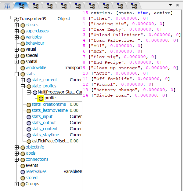

Now I have a question about the state of the transporters.
Can I use this states I've defined earlier instead of the "51"?
mlall-4-1 (1).fsm

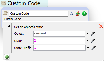

Message 11 of 28
moehlmann_fe
Sure. Since this is a custom state profile you also won't need the structure that sets the state through a message, because the default logic will never change this profile. You can thus use the "Set Object State" option of the custom code activity.
The following would set the custom profile to the "Take Empty" state.
Note that both states (default and custom) will exist in parallel and the statistics panel in the object properties will always show the state of the default profile. In dashboard charts you can choose which profile is used.
Message 12 of 28

Thank you for your answer. So for example on the "MC1" I should do like this:
In the first code I should put the state 5 that is "mc1" and in the second code I should put o that is "other"?
Message 13 of 28
moehlmann_fe
Yes to the first part, no to the second. You can't actually use the 0th state (at least not with the "setState()" method). Only 1 and up.

@Felix Möhlmann in the state profile from the chart I'm not getting the "state profile 1":
mlall-4-1 (1).fsm
Message 17 of 28
moehlmann_fe
MultiProcessor States is the name of the profile as you can also see in your screenshot from earlier. It is the first profile under the "state_profiles" node, so when refering to it by rank, as in "setState()", you use a 1. The chart properties show the name instead.
