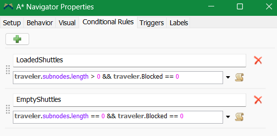

@Kavika F here is a simplified version of my model depicting the problem, the gridlock happens when there is a loaded TE in the storage bay that wants to travel downwards and another empty TE using that bay to travel upwards. Astar navigation gridlock.fsm
I have 3 layers of overlaid barriers with conditional directions and I have copied a set of these laid up side by side that you can see clearly.
I used alternating lanes to travel and up down storage slots for empty TE as part of traffic management logic as demonstrated in the Kiva model.
However when a TE is loaded, it can only travel out one direction
Do note that I added delays for 2 reasons. To compensate for turning delay as there is a stop for turns bug when used with elevator bank. To exacerbate my problem so that higher chance of unrecoverable deadlock happening for your reference. In my model that runs for 12 hours unrecoverable deadlock happens even without the delay.

Can you describe how it is meant to resolve the gridlock? At the moment the barrier direction constraints don't appear to allow any rerouting which suggests to me this scenario has to be avoided rather than resolved when it happens.
Jeanette_Fullmer
Hello @EK,
The TE are in deadlock because they can only travel into each other because of the rules of the barriers. To resolve this deadlock you would have to have the TE not fit the barriers constraints.
A way to do this would be to add that the barrier checks a blocked label on the TE. When the TE are blocked it changes this label making the TE not have to be constrained by the barrier and therefore be able to reroute. You could have another barrier with the constraint of the TE being blocked with a rule that TE follows that allows it to reroute.
In the following model there is no additional barrier. The TE will reroute not being constrained by the current barriers.
astar-navigation-gridlock_2.fsm
