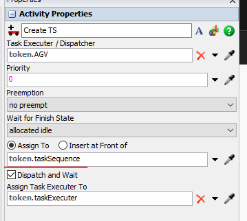

In my FlexSim model I have a Task Order table with 16 rows. Each real transport job consists of two entries: one for the outbound trip and one for the return trip. This means the 16 rows actually represent 8 logical packages, each package consisting of two rows.
What I want to achieve is that these packages are always processed completely by a single AGV (first outbound, then return). The assignment should not be strictly alternating, but instead follow the rule “the next available AGV takes the next free package in the list.” In other words, the sequence of packages in the Task Order table should remain intact, and each package should be assigned exclusively to exactly one AGV as soon as that AGV becomes available.
The current problem is that the table only contains the 16 individual orders, and the AGVs just process them chronologically. This way there is no clear bundling into packages and no exclusive assignment, which means both AGVs could potentially work on the same routes. What I am looking for is a solution to extend the Task Order table and/or the ProcessFlow so that every two consecutive rows are grouped into a package and assigned to only one AGV, while the AGVs dynamically share the list by always taking the next available package.

It seems that there is no function to save in a lower version. Instead, I will share the method I tried:
  1. Set an AGV label in the Source.
  2. In the Create TS Task Executer, assign token.AGV.
  3. Create a ZONE (if two tokens pass through simultaneously, the TABLE order gets corrupted).
  4. Assign Row 1 and Row 2 as labels for outbound and return values.
  5. Then, move Row 1 and Row 2 to the last rows of the table.
  6. I also added code in the Table On Reset event to sort the rows based on the values in Col3 when the simulation resets.

Create a group and add the AGVs, then put token.AGV.first in the UNLOAD ITEM.

Changes the quantity as shown in the figure in the source, and removes [token. row] from the target and return labels.
