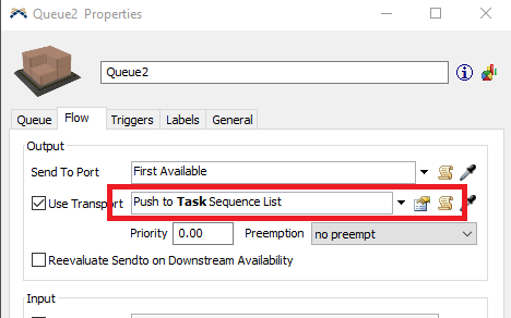

I attached a simple model using network nodes and AGV network. How do I get the AGV using the AGV network to stop in front of every bay like it is in the network node example in the attached model

I've created a reasonable working model that demonstrates how this can be modeled with AGVs. I would still suggest looking into the new Warehousing feature, which makes it possible to designate slot locations, or Benjamin's suggestion of separating out the bays to be individual racks. The model I created is rather convoluted and may end up causing confusion as more racks and AGVs are added.
In the example model, the Queue is sending the items to the rack as soon as they become available, but it's using a Task Sequence list to handle the transportation.
